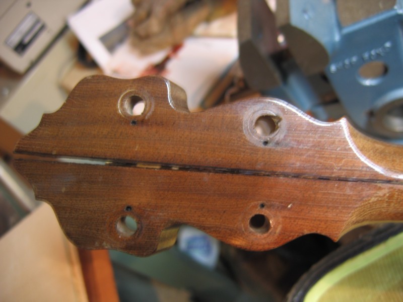

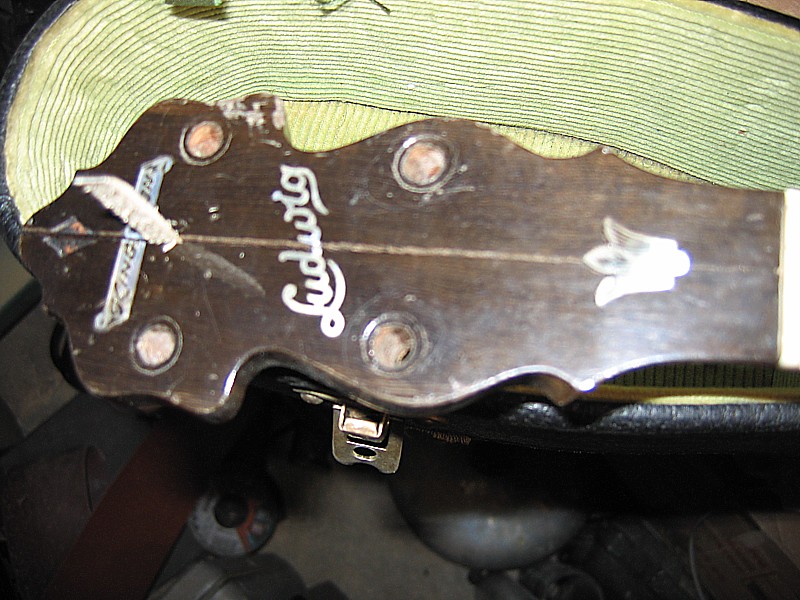

A friend of mine is a local musician and multi instrumentalist. At practice the other night another of his band mates tipped a borrowed banjo over and caused this brake:
This banjo belongs to a mutual friend of ours who has said that he wants me to repair it. I repaired a broken headstock on my Gibson ES335 using epoxy and was considering the same with this old banjo but thought I could do well with the collective insights of all of you. I have done no test and scraping to figure out the glue used here. It has split right on the seam of the three piece neck and has split the single piece ebony headplate and popped the diamond inlay (which I have and will CA back in place at the end of the process).
So, is epoxy the right choice here? Or should I try to clean the joint out and get some hide glue in there, or....
Thanks in advance.

I'll defer to others more experienced with repairs but would have thought that hide glue would work fine.
PostPosted: Wed Oct 12, 2005 9:51 pm
I'd say it's all according to what it was originally glued with. If you know it to have been hide then that is the obvious choice. Otherwise I'd go for epoxy. Mind you my first idea was right along with Dave's the only other thought I had was to give him an accordian instead and make him a real social outcast.

Epoxy has no place here! This is an old and nice banjo, you want to fix it right away, don't let any glue into the joint and just fix it with Hide glue. I haven't yet looked at Franks' solution, I'm heading over there right now.

Re the cracked banjo headstock, I would look closely to determine whether the trauma caused internal stresses in the wood to "give way". If this is the case, gluing & clamping may reintroduce those internal stresses, raising the possibility of the split re-occuring. A new spline may be a better solution. (but more difficult for sure!)

Ok, I found Franks' repair that Doug talked about earlier. first, for you folks who post links here- it's much easier for people to get to your link if you use the "Add hyperlink" feature here. Then your link is "hot" and people can just click on it. for example, I could not get Doug's link to work right for me by copying and pasting....so I had to search all over Frank's huge site to find it! But I did find it, and here it is for those who want to click on it- Franks' Peghead repair.
My thoughts on this one....the damage to the banjo was from a fall, and as far as Shane or anyone knows, that center lamination was stable and all just fine before that. Franks' repair deals with a center strip that has degraded, and is falling apart and not damage from a fall at all.
So the dowel, and a lot of the monkey business isn't needed here. If the joint still stays in alignment when you dry-clamp it shut, then put some hide glue in there and clamp it up. If it isn't in alignment then you'll need to make a couple of cauls that will sandwhich the peghead to keep it aligned, then glue and clamp the whole mess.
Do a good dry-run of the whole process, and have it all figured out before you go for the glue, and then go for it! Don't forget the wax paper to keep the cauls from sticking.

In the photo's I have the crack opened up with a wedge of spruce (I have lots of that around!). Otherwise everything is inalignment and does close up very nice. You can see the crack on the headstock but that is probably the lacquer crack that is most obvious and I think I can repair that pretty well by just rubbing the surface with a rag soaked with lacquer thinner. It has been years since I used hyde glue but I remember how brittle it can be when dried. Should I be trying to scrap some of this old glue out to ensure that we get good adhesion at least on parts of this seam? Should I be asking Amy H about this?

Shane, I would just put some fresh glue in there and glue it up. The crack just happened, so it's clean and the new glue will heat and melt and blend into the old glue. Part of the beauty of using the hide glue is the fact that it was already made and glued up with the stuff, so using it to fix it makes a lot of sense. If it fist together well, then it'll glue up well and no need to get in there and scrape. Remember the first rule- do no harm!
And with that first rule in mind, I want to say DON'T use the lacquer thinner. After the hide glue is dry, just clean up the surface with warm water on a rag and see what you have at that point. Lacquer thinner will eat the finish on it and make a big mess! if you have to put anything on it, use shellac.
